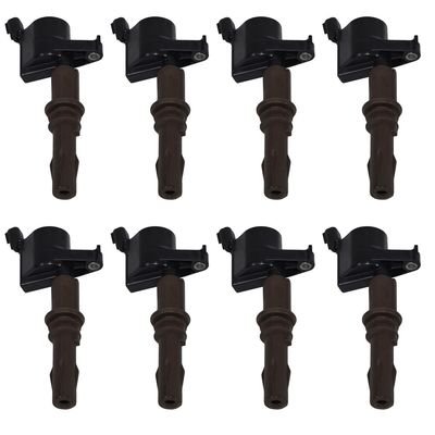

What are "boots"?
Imagine that...way for them to make more money I guess...convince someone otherwise.
Blue items shown here, from the coil and over the plug, if one cracks or is just worn out spark will arc and take two paths.
