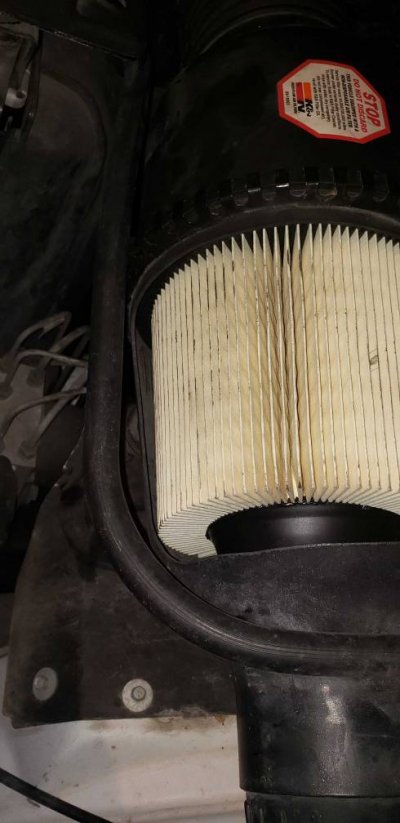

i keep getting various code. i doubled check all my vacuum lines and seem to be fine.
P0174 would usually be the 1st one to pop up.
but this time P1151 showed up.
after erasing codes. truck feels to run good for about 5minutes before getting more aggressive on the tractor diesel feel. to ñater come to a rolling stop.1997c03a93b4552c3d29e8c634204bf5.jpg

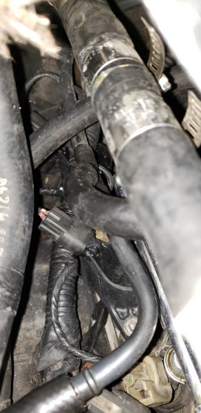

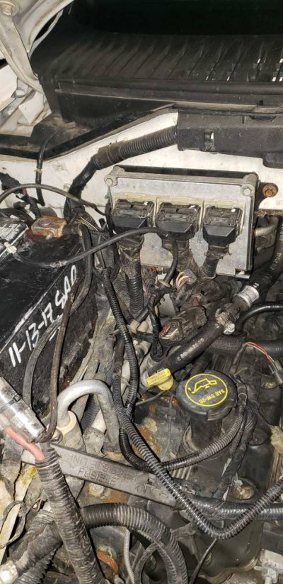

what i did notice previous owner did some stupid cutting to the box man...
but truck was running fine with that like that..this was something recent. thats why i stopped driving it. thinking it was Misfire due to sludgged (oil) spark plugs. and burnt looking coils.e253b39467472a74f3677ef8652033fe.jpg1ab614bfeccf65acd334a781a60eadd1.jpg

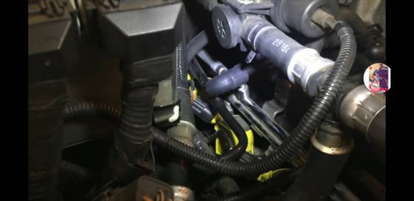

just saw the video. woah. passenger side. ok let me outside and give a quick check

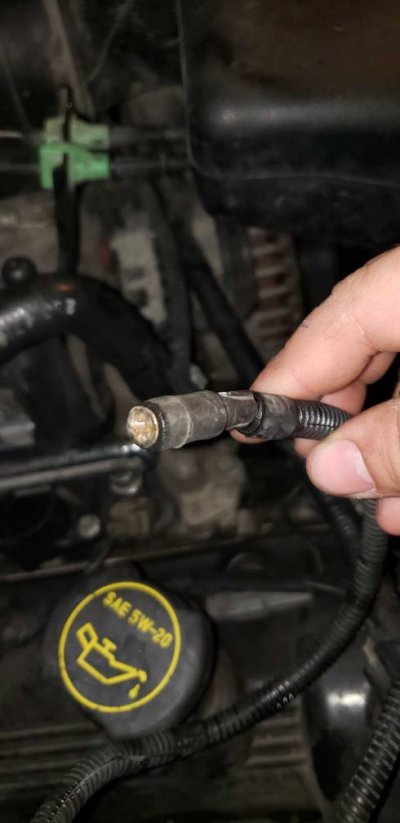

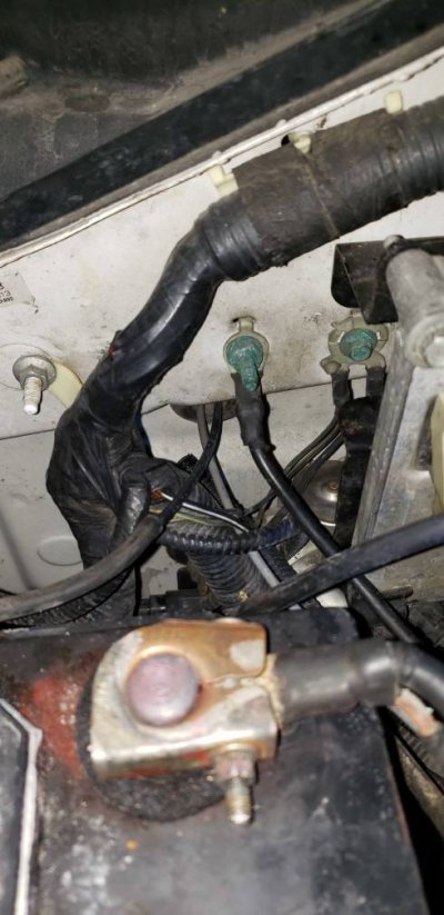

ok. so i whent to check it out. and that side looks like spagetti to me man.. apprantly it doesnt have the Elbow but its a Y insert. i found this vacuum like with a screw in. i cannot see where it goes to or comes from....fbbd4b0f01d20e36210180dff7c92b08.jpg8ca6d0633bed3de6b1eb5d02d1bd7c25.jpg57cdeb8a9337277c3d6d42169142f52c.jpg294b2d91428ff2bc7e37021734f15900.jpg

...wait.....
im missing that top right component going into the heater hoses??
i want to say it would funtion like a regulator?

I cant tell WTF you're doing. The elbow I replaced was right next to engine way in back by firewall, passenger side. I recognize most of those pics you posted and wrong place.
that last pic is right but that's not your vehicle is it?

yupp. all the wiring is spaggeti. nope thats from the video some one posted here.
