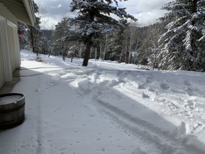

The idea is stay in the lowest gear going down and up the asphalt driveway. From the street, the driveway is up and straight @ ~7-8 degrees, then makes a 90 degree left turn for ~40' @ ~10-11 degrees then on the concrete garages apron, with the garage doors 90 degrees to the right.

This time, after backing out of the garage in 4WD/snow, putting the XLT in M1 I was able to (after a lot of very slow maneuvers) get the nose pointed toward the house so my wife could then back down the step part of the drive to the turnout then go forward down the rest of the drive. M1 was the only way I could get traction up top. Costco Blizzak snows will be installed Monday! Coming home, she stopped at the bottom of the drive, put the XLT in M1 and maintained speed all the up and through the 90 degree left to the garages.
