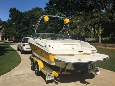

brick
Aug 11, 2016
77
Atlanta
image.jpeg On my new 2016 Limited, when you get the 22inch rims you get adjustable suspension. Not self leveling, but three driver selectable modes - comfort, normal and sport. I leave mine in "sport mode". I tow a 6000 lb boat ( no WD hitch) and there is no rear-end sag.

View attachment 17938 On my new 2016 Limited, when you get the 22inch rims you get adjustable suspension. Not self leveling, but three driver selectable modes - comfort, normal and sport. I leave mine in "sport mode". I tow a 6000 lb boat ( no WD hitch) and there is no rear-end sag.
That's a sharp looking boat. Who is the manufacturer? I have a 21' Ebbtide Cuddy, which I believe is about the same size as yours. I tow it with an 03 Expy EB 5.4. No sag in the rear and no sway at all.
I recently bought a used 13 Navigator but haven't towed with it yet. I was going to sell the 03 but it's in great shape and does the heavy lifting. I'm going to keep them both for now. Happy Boating.
The boat is a Chaparral 220SSi, with a 350MAG/MPI Bravo3. I towed it with my 03 EB, which towed it fine, but the new Expy tows like the boat is not there. I really love me the EcoBoost.
