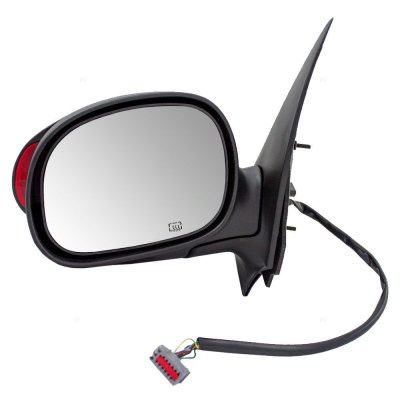

There are at least three different turn mirrors
  • Red Signal Arrow behind glass encased in backing plate: Non-Heated, 5 lead connection
  • Red Signal Arrow behind glass glued to back of mirror: Non-Heated, 5 lead connection
  • Red Signal Arrow on plastic mirror cover: Heated, 11 lead connection, bulb is serviceable.
  • Amber Signal Arrow behind glass
