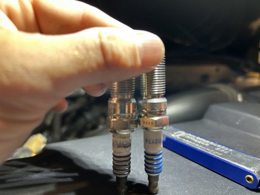

update: figured out my issue order all new oem coils and to humor my self I order 6 more new plugs from a reputable site , as I was swapping out the plugs it caught my attention that the coils would never snap on the on previous new plugs I put in , turns out those “open ford plugs” I bought of eBay were knock offs and about 1/8” shorter when seated caused some type of arching between the plug and coil , no more codes
