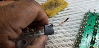

went back to tranny shop- used high tech scanner,.. picked up code PO2031- which is Low Voltage Fuel Pump Secondary Circuit...
( in short the $12 R303 relay for the fuel pump located on the Circuit board is failing... ) [Dealer cost repair around $800-900]
So I Paid a buddy to remove/re-install the board so I de-soldered the worn out relay, and re-soldered the new relay onto the board.
I worked, started up fine, and since i have had no issues...

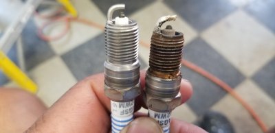

I then decided to have my spark plugs replaced. got a tech from the dealer that did side work- at my house, (cheap labor).
My plugs were all worn to hell at 98k, Causing all kinds of problems, the biggest being Hesitation upon take off...( New plugs solved this problem)
Never had a check engine light.
seemed like a skip in the diff, or torque converter, i could never pinpoint the issue... Spark plugs made my SUV run better than it has in two years.
(Recommended spark plug change is around 100k... I will have these replaced when i hit 150k... I have no issues, and it idles smooth as glass.
