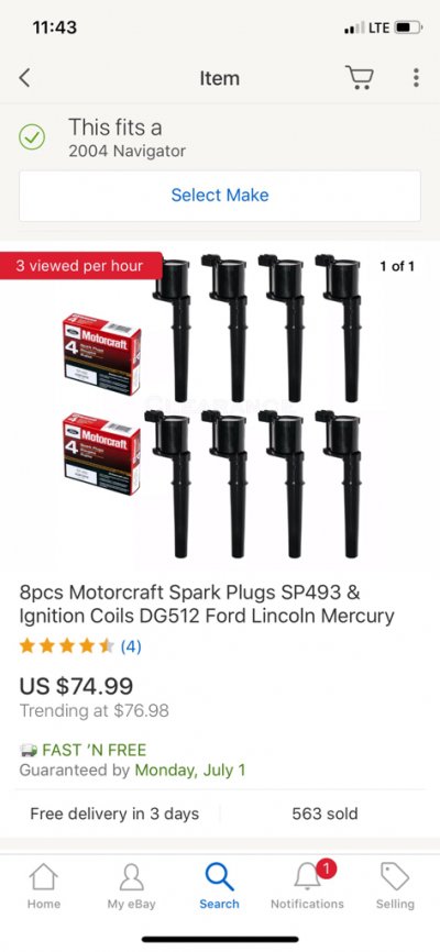

    Are any of the eBay kits better than others? I usually buy motorcraft or other known brands with a good reputation. I’ve heard off brand coils can be crap-what so you think?
    I was looking at this post because of the MC plugs.
    [​IMG]

    It's just a crap shoot either way you go. I saw those sets too and if you do the math they're slightly overpriced. They're just using the Motorcraft plugs to make you think you're getting a Motorcraft coils. I can buy the plugs locally for something like 249 or 299 a piece and O'Reilly Auto Parts so check around and do the math. You can even get different color coils if you look around but you're not going to be able to see these anyways. I actually like putting the red and the other ones on my Town Cars as opposed to the black ones. Lots of aftermarket to the parts stores are gray.
    There are lots of sellers that show cutaway cross-sections and talk about 100% copper coils and stuff like that but you never really know. I have had great luck with all of them and I've use four or five different sets of the ones I've eBay.
    Most have at least a one year warranty. If you search you can find longer or lifetime even but will the seller still be there or will you be able to contact them when you have a problem? Probably not. Locally these calls are about 40 bucks a piece with a lifetime warranty but it's not worth that much of a price increase. I can get them 4 $5 a piece or less and at that price I'll just throw one in the glove box and I always have tools with me so if I'm ever on a trip I can switch one out. And they're not that hard to do especially since most of my vehicles are Town Cars and they're even easier.
    I have to ever have the set start going out in less than a couple of years I will look for a higher-quality call but so far the earliest I've ever had one fail was around eight years. That was on a V10. I ended up having two fail within the 8 to 9 and 1/2 year period.
    I buy older higher mileage vehicles so almost everything I buy has a cool or two replaced with a different brand anyways. I just go through and put a fresh set of them and plugs and keep all the old ones for backups and test purposes.
    When most people think they need a tune-up they really don't even need coils. Normally they should just put some new plugs in and replace all the rubber boots on their coils. Then if you later have a misfire you can check with the scan tool you might have to do a coil. Different ways of going about it I guess.

    I was thinking the coil/plug set was cheap-like you said-buying just one coil locally is at least $40. The same plugs with the kit are $3.69 each at advance auto. I did order a kit like the one I sent the pic of. I’m sure it will work just fine. I have 3 old navigators so the spare coils I remove will not go to waste.

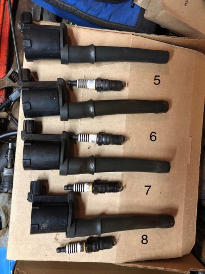

    Ok-I’m out in my garage under the hood of this fancy misfiring Navigator! I snaked the cover off of the plugs/coils (my 99 doesn’t have a cover so they’re easier to get at)!
    Can I somehow move this big braided covered whatever it is? It’s sitting right on top of the coil which made getting the cover off a challenge. The locking tab appears to be broken off the coil plug in too. I’m guessing I should put a new tab on it?
    [​IMG]

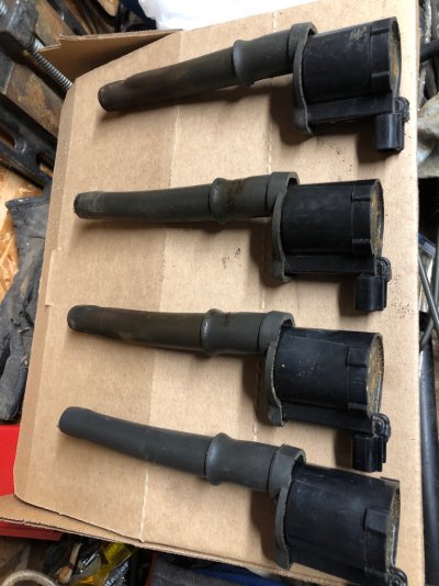

    Got it-i wiggled it out but it looks like it will be a real challenge to get at the plug in that spot.
    The rubber boot on coil #8 looks misshapen-like it’s squished together compared to the others.
    I see the cover must hold them down. There are small bolts that hold them down in my 99.
