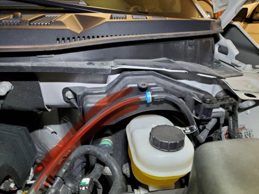

Howdy- I have been lurking since I bought my 2019 Expy Limited stealth edition about a year ago.
While checking the oil yesterday, I noticed a vacuum check valve clipped above the brake fluid reservoir with an open port on one side. I looked under and over the engine compartment as best I could, but could not find a dangling hose or open port. I don’t believe it’s been gone long, as the open nipple was very clean -maybe pulled the line off traversing high water in the floods we had here a week or so ago.
My nearly 70-year old body isn’t as flexible as it once was, and I could not locate a vacuum diagram here or on other sites that located what need.
The line highlighted in red is the one missing from my Expy..

Nope, I have already searched and read the forum posts-not concerned with grinding or changing a check valve -just would like to know where the vacuum line that I highlighted in red connects to on the other end. Have also searched online for a vacuum line routing diagram, but haven’t found one that identifies the termination or route of the line I’m missing.

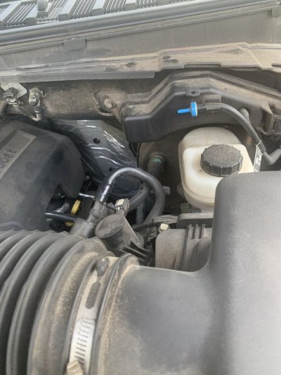

Your photo shows the vacuum line I am missing as well

Bought mine in December, i have the blue check valve but the supply vacuum line was removed and capped off. I remember seeing a video about it but can't find it.
