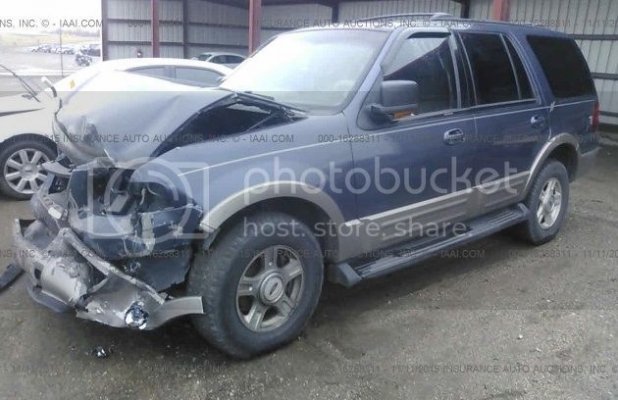

Hi, my name is Bob, I'm new on this forum. I bought the Expedition for towing and so my wife can drive to work when it snows. I'm from Nebraska. I work for a company that makes slow moving vehicle signs. A long time ago, I use to swim for the University of Nebraska mens swimming team, go Huskers

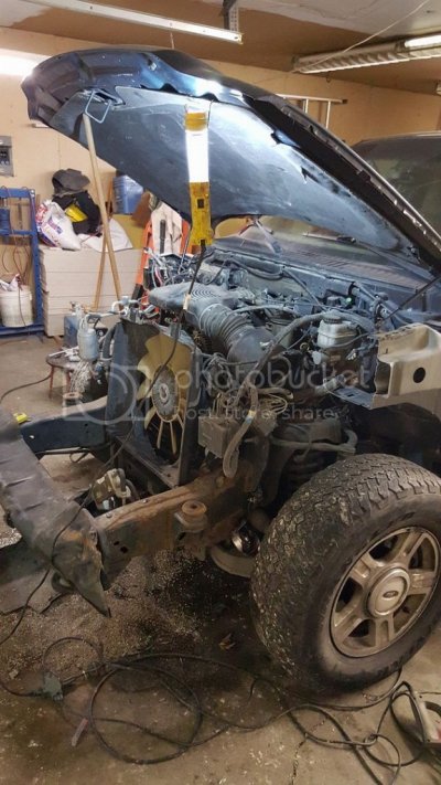

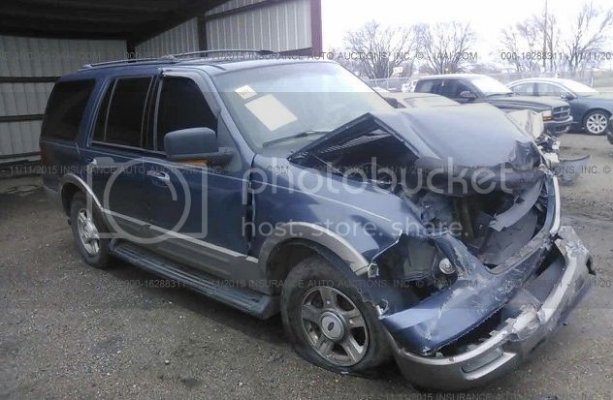

Just bought a 2003 Eddie Bauer with front end damage for $300. I plan on getting some parts from U pull it and U pick it in omaha and kansas city, as I see they have some of these in their inventory. I've painted lots of cars for myself and family over the years. I have a chassis liner lift n' rack to do minor frame work. My first goal is to get it to start, I think it just needs the fuel pump reset after the crash, maybe some wiring too.

High hit, so the frame is not damaged at all, it's isolated to the radiator/ core support.
It started up and runs excellent. Nothing mechanical was damaged at all. There is a lot of room in the engine compartment for crash damage, so I'll get away with just replacing the radiator and core support. The oil coolers survived too. Even the battery took a charge and is now at 100%.

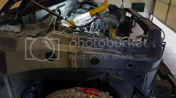

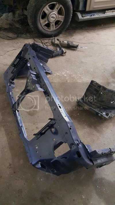

I decided not to chop up my other parts car, so I bought a front clip, structure only from United Auto recyclers for $110 and it was rust free. I painted it blue.
Then I cut off the damaged front clip and created sleeves for the boxed section of the new clip to slide over and give me some adjustment to make sure the fenders and hood all lined up.
sleeve for box section of upper apron:
Then I checked fitment, and once I was happy, I started welding it together.

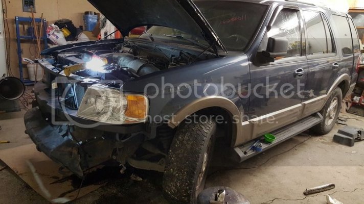

Then I put on the fenders and the new headlight mounting reinforcement that I got from Ford and put in the headlights.

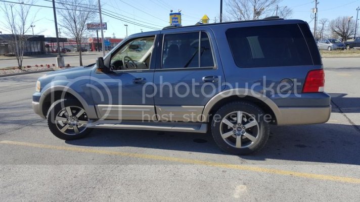

Now my wife is driving the Expy and she loves it.
I replaced two spark plugs, a coil pack and one boot and fixed several broken vacuum lines thanks to the help from others on this site who had the same vacuum leaks and pointed me in the right direction. Now it runs smooth and drives great.
