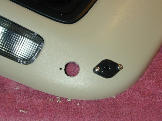

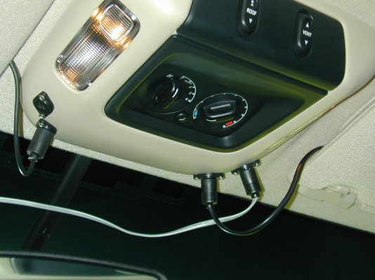

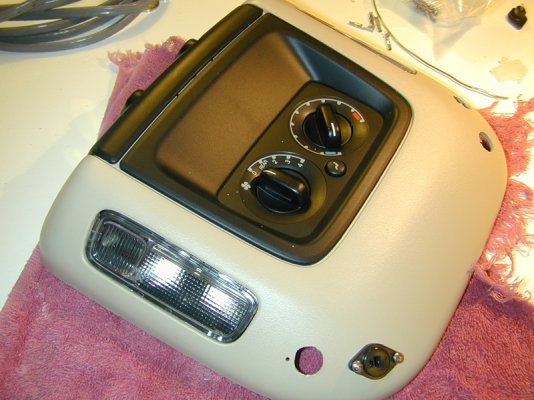

I don't know about you guys but I have gadgets that I mount towards the upper edge of the windshield. I like to have the GPS on the upper left side so I can get to it with my left hand; I also like to mount my radar detector high to catch the hits earlier.
Previously I would have all these cables run to the back of the rear view mirror and then dangle down to catch the cigarette lighter socket on the console, which then would have a 3-way splitter for 3 devices. Yes it is geek cool but quite messy.
My mod number 3 is installing some mini 12V sockets on the overhead console so all these devices can be plugged overhead with no dangle cables.
Well, I know it is not for everyone but I like it.
I found these connectors/bases which is much smaller than those obnoxious cigarette lighter sockets.
I only need to plug 3 devices but I put in 4 while I am at it (just in case I want to get an Auto Suck later)

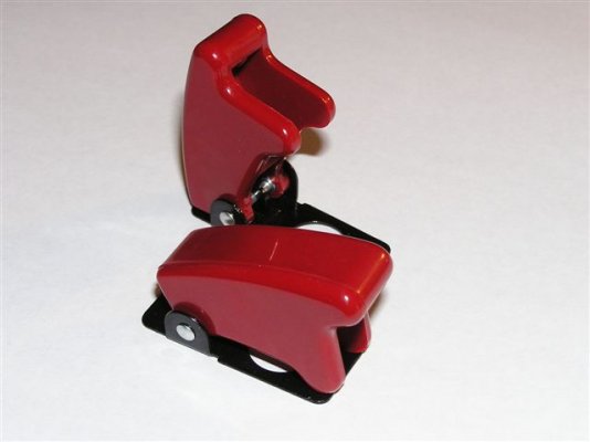

BTW, thinking about aviation, when I was designing that 'gadget control panel', I was deciding what kind of switches to use, I almost went to these babies. I see these in Top Gun movies since I was a kid and I always thought that was so cool to "flip the cover and engage". And you can get them in all kinds of fun colors.

I have one on me right now, I'm going to use them for the rest of the strobes I have. I got em at a electronic variety store. You can find em quite a few places, if you I can get you some as I need to get a few more. The one I have has a backlight for the switch too. Only I'm not sure if I'll be able to wire it so the light comes on when the switch is on. Have to test it with a meter, as the two share a common ground/supply.
I like how when the cover closes it turns off the switch too.

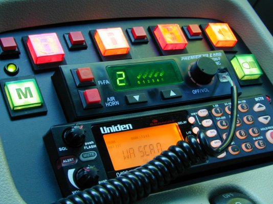

Thanks but I have decided to use the lighted square buttons. They allow me to put graphics on them, as I did here.

Love it, very professional. What did you use to get those graphics there?

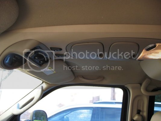

I need to figure out where to make one, my console doesn't run into the dash. I was thinking take out the garage door opener thing in the overhead console and work in there.
same idea but beige interior. any ideas? Need the center console for work papers.

To answer your question, the graphics was the easiest part, I just drew them up on the computer, then printed them on a clear transparent film (that is made for laser printers), then just cut them out and stuck them on the buttons. In my case since I used these square buttons, the color (red, amber, green) part is actually a colored "cap" that goes over a white lighted part, so all I had to do was sandwich the film in between and voila, done. No glue, no mess.
I will try to give you some ideas/suggestions if you can snap a picture of your overhead console so I know what it looks like.

I'm thinking take the door off, and shave down the tabs a bit, then put a plate in there in place of the black dome. Would make getting the back light circuit easy.
Want to put strobe controls, and a switch and indicator for high idle. And move the current switch up there. Thinking I'll use those aviation style ones and get different colored covers for color maybe. Colors and location will determine which ones are which.

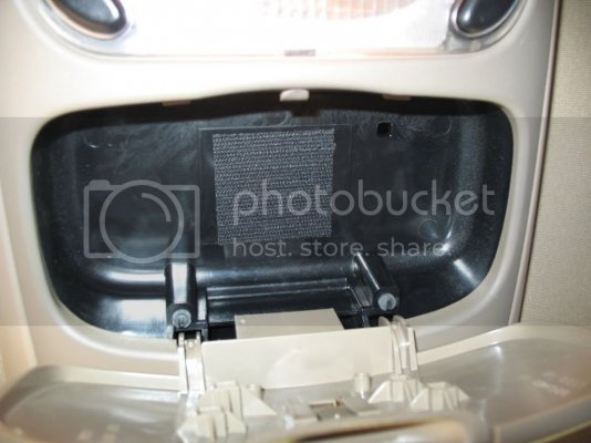

What is this compartment for?
My opinion is that this is the perfect spot for your control panel. It is large enough and is in the correct spot when you are driving. Really cool flipping overhead switches - like when you get into a jet ;)
Why don't you pull this panel out and snap some pictures of the back?

Thats a sunglasses compartment. I use it, although come the situation I could ditch em. It is in the better position and give more room. I was thinking the jet idea too, already excited to use them lol.
