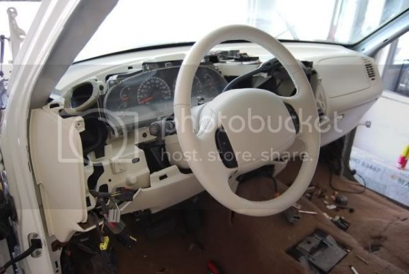

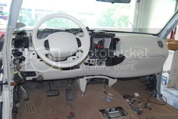

The bag modules remove as an assembly. There are two bolts that hold the drivers air bag to the steering wheel, they are accessed from the rear. If you intend to remove the steering wheel, do not remove the clock spring from the column. If you do it will unwind and you'll have to buy a new one and have the system service by a experienced Ford tech.

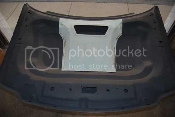

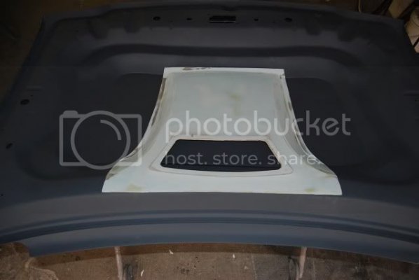

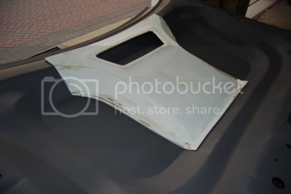

Close to finishing my custom hood!
After 50+ hours of fabrication, sanding dust etc.....I finally nearing completion of my "one off" GT hood.
Here are a few photos of the underneath. The panel, without primer, is going to remain a bolt on part. The hole will be covered in mesh to keep out debris out of the engine compartment. Tomorrow I'll prime and attach that piece and then bolt it back on the truck for a final fitment before paint.

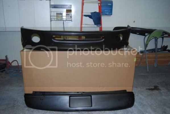

Just got in my Stillen lower front bumper valance and rear roll pan. The front valance is really for a 2007 F150 so I have to make some adjustments to make it work. It is designed to fit over the stock 07 lower bumper on the F150. So I also have to buy a lower bumper bar and brackets. I may also have to cut off and buy the frame horn brackets off the 07 and weld them to my frame to get this all to work.
Still waiting on my Bell Tech lowering keys for the front (already shipped) and I went with DJM 4" coils for the rear. Those are still a week or so away. I'll probably will have to "C" notch the rear frame to give the rear enough clearance though.
