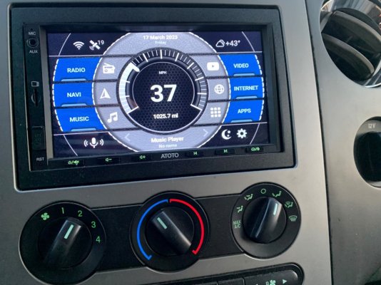

I went with an aftermarket Android head unit for my 2007 Expedition XLT. Backup camera, GPS, digital speedometer, radio, any internet radio and video. And since it is Android I have Forscan loaded and can easily monitor my vehicle while driving.
I do think it provides a more modern look to my first year Gen 3.
