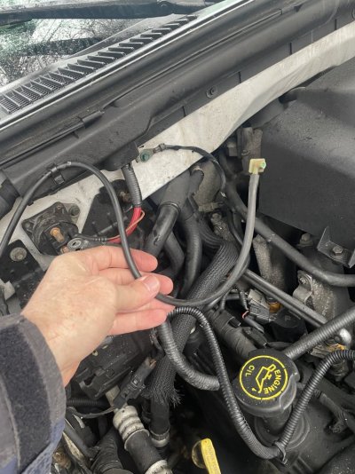

Need help. I accidentally ripped this out.

Washer fluid squirter? Where’s the other end of the hose go to / come from? Is there fluid inside the hose?
Yes, that is the washer fluid hose. On my 1999, it connects as shown in the picture. There is a plastic T or Y connection underneath the hood liner that routes the flow to both nozzles.

Washer hose is impossible to buy at auto parts stores. But Lowes and Home Despot have drip hose for irrigation that is that size.
