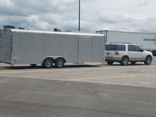

This is a good place to start. The cat. I have his exact rig. 2k lbs you shouldn't even feel behind you. Something is definitely up like you suspect. The only time I feel what I'm towing in the below pic is if I'm on a long or steep grade or it's windy. Over 16k lbs GCW last time I towed...
