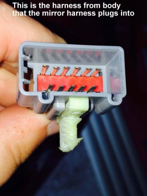

Here are some pics that will hopefully make the issue very clear, and hopefully help yall help me find a way to make this stuff work so I can move onto other things with this truck.

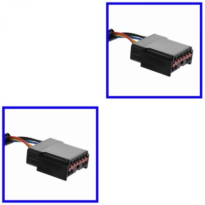

This is the pictured plug from those Ebay tow mirrors..personally it looks just like the wrong plug in my last post? Curious what I need to do here..

Absolutely, plugs can be cut off and connections can be soldered together. Just need to be sure of the wiring on both sides. Can probably just as easily rearrange the pin-out on one plug side or the other. (IE: move wire #4 to position #7) I'd ask the ebay seller if he is using a stock photo or the actual part.
I'd probably not invest $400+ in mirrors for a $1500 truck, but if its a towing rig you want, then the telescoping mirrors are the way to go.

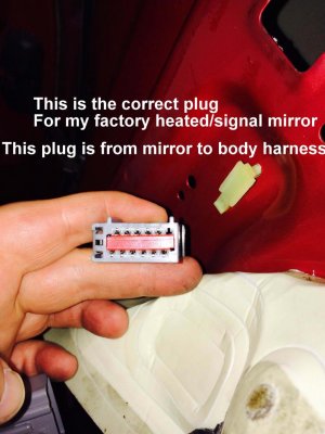

I've actually found what the problem is, I could have sworn my truck had factory signal mirrors but it did not.
It has heated mirrors with no signal, but it has the option of the memory mirrors for an additional driver. But all of the mirrors I had been able to find had the wrong plug.
I found the correct set of mirrors on rock auto with the correct plug, but they are only heated and not signal.
I also noticed there is a set of towing mirrors that look exactly like the ones that come on the new F150, they say they are for a 2000 expedition but in the picture it has the same plug that I can't use.

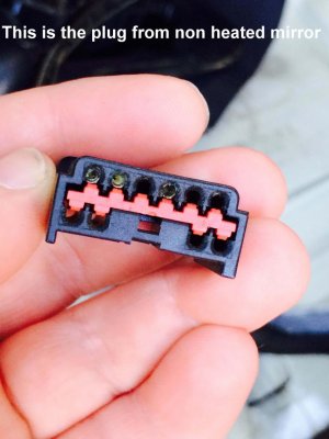

I have an '02 XLT with power heated mirrors - no turn signal. My connector is NOT the same as the pic you posted.
This is what my mirror-side connectors look like.
You could rewire, but it might take some time to get it right.
