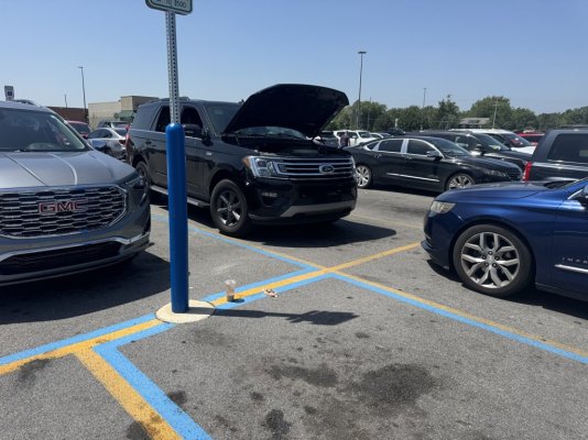

So my ‘21 had a sudden onset of wrunnung rough then died while my wife pulled into a retail parking spot. It would crank and if it fired it ran like a diesel for a few seconds then died. Tried it a few times with no success.

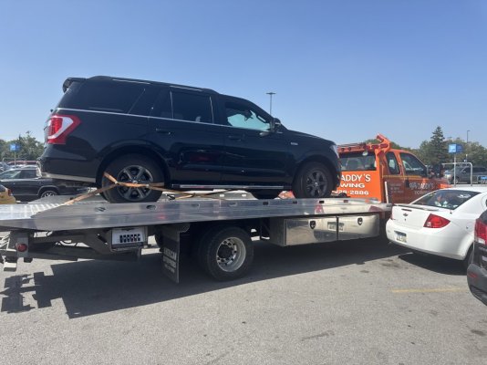

Called AAA for a tow but couldn’t get it out of park and in neutral due to the electronic trans. Finally got mobile assist from my local Dealer who initiated the manual park over ride and eventually got it winched on the flatbed and taken to the dealer. NOTE - this was last Wednesday and it was nearly 100* out.

Thoughts? Does this actually happen?
