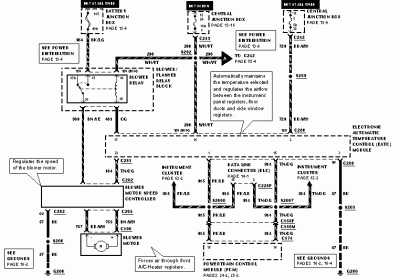

Does anyone know what the voltage at the EATC head unit and at the actuator should be? Also, the back of the head unit has two wire harnesses. I'm presuming that one is the power and other connections to the unit and the other is the connections out of the unit. Am I close to being right? Any help with what each of the colored wires is would also be helpful.

This is the same vehicle I have. Currently having problems with no heat. All actuators work on this one. I have the workshop manual if you need any other diagrams or install/ removal info.

Thank you very much for the diagram Maverick. I really appreciate it. Do you have a diagram showing the wires to the blend door actuator?
