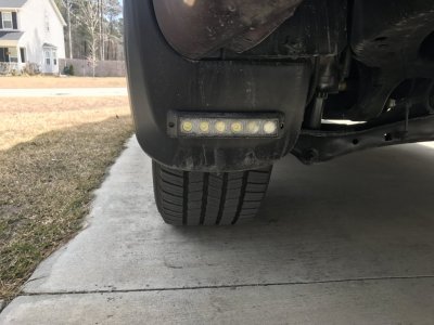

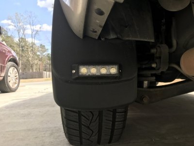

They don't seem adjustable, as in the pic seems most of your light beam is aimed more to the floor than the garage? Can you try shimming the bottom to give it a better aim?

The picture of the light spread against the house is a little bit misleading; my driveway slopes up to the house hence the splash directly behind the truck.
