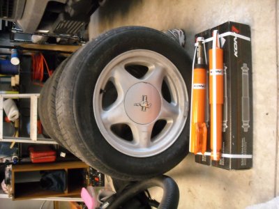

Good YouTube video on how to install using Koni's. But it's the same process. Discusses how to align the spring/strut prior to installing in order not to have what you're experiencing. Good choice of shocks tho. FoMoCo's are junk from the factory. And Monroe's allow bounce back. Koni's and Bilsteins are my fave!
