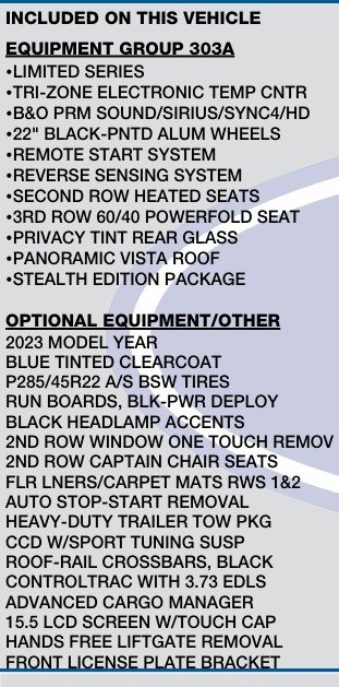

I just acquired a 2023 Max Limited Stealth 4X4. It shows lots of things included that I cannot find any "official" info on. Hoping to find someone who can point me to solid information. The window sticker shows to have Equipment Group 303A, with 11 items listed below that line. Are those 11 items what make up E.G. 303A? The last item (#11) is Stealth Edition Package. Exactly what is in the S.E.P.?
Under Optional Equipment/Other is:
Control Trac with 3.73 EDLS - what is this? (The door sticker has an axle code of 3L)
CCD with sport tuning Susp - what does that mean or add?
I'll attach door sticker and part of window sticker below.

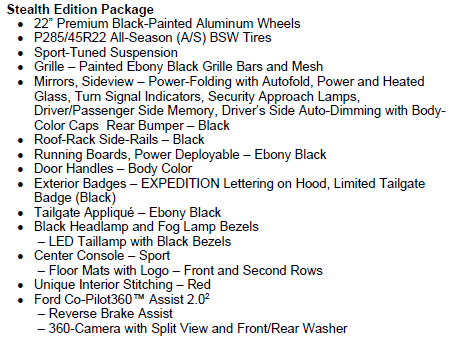

From the 2023 Expedition Order Guide, these are the features included in the Stealth Edition Package (303A):
ControlTrac with eLSD (3.73 Electronic Limited-Slip Differential) is a final drive ratio with 3.73 gearing. The function of the eLSD is explained here by @LokiWolf: https://www.expeditionforum.com/thr...ntial-only-on-tremor.57857/page-2#post-525227
The Stealth Edition Package includes "Sport Tuned Suspension". CCD adds continuously controlled damping with road preview. The computer supposedly evaluates the road contour and tunes the dampers (shock absorbers and struts) accordingly.

Thanks bb37, the link helped.
So 303A & Stealth Edition Package are the same thing?
I found the axle code 3L = Limited slip 3.73
Yes. "303A" is Ford's order code for the Stealth Edition Package.
Note, some folks may get a little salty when you bring up these packages as there is a Stealth Edition Package (303A, sometimes abbreviated SEP) and a Stealth Performance Edition Package (304A, sometimes abbreviated SPP). 304A includes everything that's in 303A plus the High Output 3.5 Ecoboost engine (440 HP vs. 400 HP for 303A), dual exhaust, 3.73 non-LSD axle, red-painted brake calipers, B&O sound system with 22 speakers, and enhanced active noise control with engine sound enhancement.
