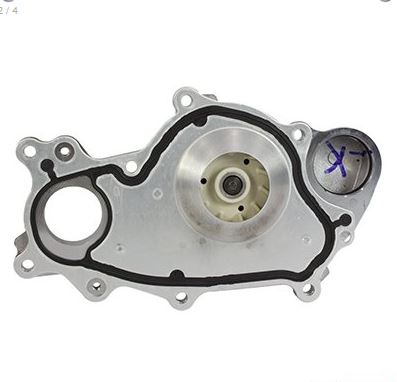

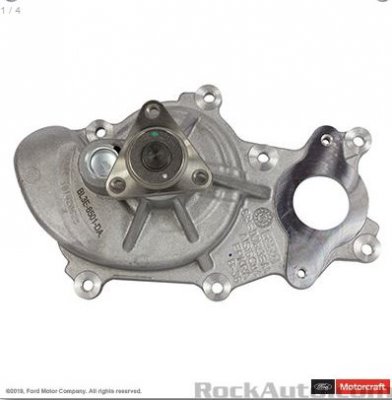

I've done a water pump on a Ford modular v8 before, that was probably the best water pump design ever, one big oring. The water pump on these doesn't look particularly hard or anything, but it's not near as easy as those were.
There could be a very easy and inexpensive fix for this. If the 3.5 Eco is anything like my Triton V8, the water pump has a giant O-ring around it where it connects to the engine block, which can start leaking.
After I removed my leaky water pump two months ago or so, I could clearly see that the likely source of the leak was this O-ring seal. Rockauto and other places sell new ones, or complete water pump assemblies with the seal. FYI, my water pump lasted 132,000 miles and it's an ex-cop car, so it must have some good idling time on it as well.
Btw, that Dexcool-like orange coolant Motorcraft uses is sh*t. Mine turned brownish and had gooey / sticky brown floaties in it, deposits of which could be found on the pump gasket and on the radiator cap. I suspect it's what made it leak, as it was stuck to the O-ring gasket in one place where the gasket got deformed. I flushed it all out and replaced with Prestone's green OAT coolant (suitable for all vehicles).
When replacing the pump, make sure to grease the O-ring before you put it back in, as it's very easy to pinch / damage this seal if you try to do it dry... also, use equal force on all sides when pushing it into place, then finish by torquing the bolts a little at a time so it goes in straight.
