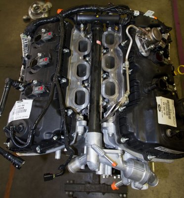

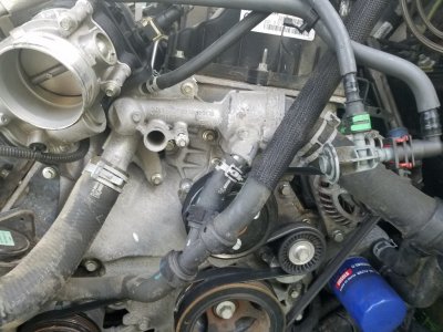

Very easy to swap out the 3.5L water pump. I did it on mine, but not because it failed. The accident pushed the hose connection a little and that caused it to leak.
The biggest thing I can say is BE CAREFUL of the tube that goes from the rear of the pump under the intake and to the back of the engine. It can pop out of the rear easily and it can be a ***** to get back in. I ended up cracking the rear housing and had to replace it.
The hardest part of the whole thing is getting the turbo tubes out.
