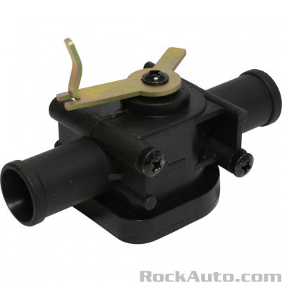

Yes, you should have a hot water control valve in the heater hose going to the front heater core. After you replace the thermostat feel the heater hoses and make sure they're passing hot water through them. Probably wouldn't hurt to replace the control valve if it's original.
Hot Water Control Valve at Rock Auto
