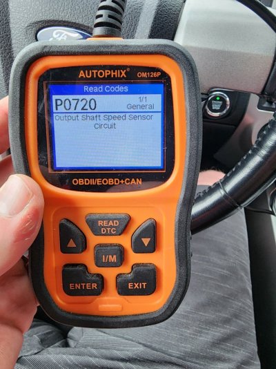

It did it twice today. I had a scan tool with me the second time.
P0720 was the code given.
Again just shut it off and turned it on and it drove perfectly fine.

Sorry a little late on the reply. I ended up replacing the lead frame in the transmission and that fixed the issue.
