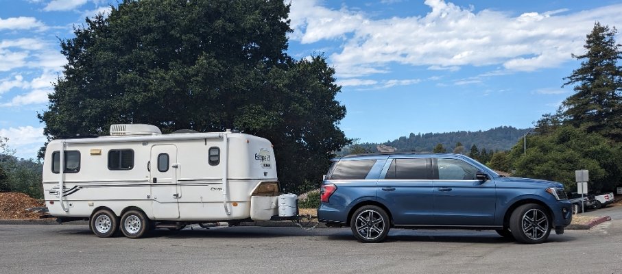

FWIW, my '19 Stealth Limited tows my 5000 lb GWR Escape 21' trailer just fine, using an Andersen WDH. I run around 500 lbs tongue weight, without the Andersen it has a tendency to sway at speeds over 65, especially if there are bicycles on the back of the trailer (which puts the tongue weight on the too light side), with the Andersen its rock stable. My Expedition has the CCD shocks, and is a 4x4..
(picture taken before I got the Andersen.... I towed this 10,000(!) miles through Mexico without the WDH, but got it promptly when we returned home)
