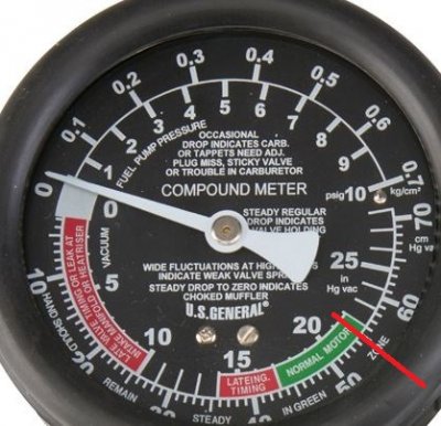

I did put a vacuum test gauge on it and it sits right at the little red line i painted on the picture. I don't have a smoke machine would using my air compressor and pushing air in from say the break booster line and and cap off the throttle body do anything for me? Thanks

You need to press down the brake pedal & hold to put a load on the vacuum to see if it holds at that line.
