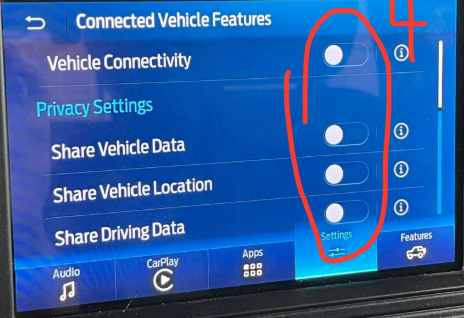

In your touchscreen, go to settings, connectivity, connected vehicle features, and turn off all the data sharing options. I can't find any pics of an Expo screen on Google, but looks something like this.

This stops notifications, but not reports to the mothership.
Not sure what you mean about notifications, but from my understanding, this stops sending the driver data to the cloud but keeps the modem working for the Ford app to work, OTA updates, and other connected features to continue to function. If you want the vehicle to be completely excommunicado from the server, you'd need to unplug the TCU.
