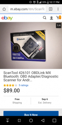

Forscan is great! You can edit some electronic features with a laptop or use your smart phone for monitoring. This is the adapter I recommend

I have some insight on this. I have the obd link mx adapter. With torque you are unable to see trans temp. With the software that comes with the obd link won't see it also. Now the forscan will. So if I were you I would get the mx adapter and forscan. It take a little playing to understand how the interface in forscan works, but it does work good.

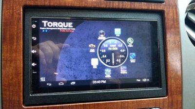

I have Torque Pro on my Android head unit. Yes you can see trans temp with it. I have an ATOTO head unit and the OBDII adapter they sell with it. You just have to configure Torque pro with the Ford PIDS that come with it
Its real nice to have the temp readouts easy to see on the head unit while towing, no fiddling around with my phone. This is what it looks like, I do not have pic with the actual gauges displayingIMG_20170524_174309322.jpg
