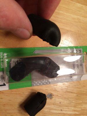

WoW. I went out to driveway and located this elbow. It looks fugly, all buckled in and collapsed. I started engine which ran great, reached down and pressed on the buckled area and hear gushing of "vacuum leak" caused by pressing on it. Cycled this a couple times to make sure. YUP. Then engine dies, restarts by itself (I used remote to start it initially) and dies and does this a few times. Turned off with remote. Golly Gee think I found my problem, or a problem anyway. Now going down to Advance Auto (in my OTHER Expedition) to buy that elbow and install it.

If you followed my posts above. I bought that rubber elbow and installed it. I think I did it right, sure was difficult to slide on, I might have ends reversed? Started Expy with remote and it went back to starting & dying, starting & dying. If I put key in ignition to start it, starts and runs fine. Did both ways several times. That is ODD. I'm stumped now.
