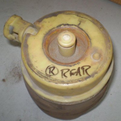

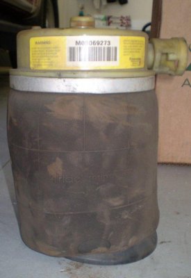

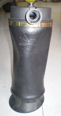

as far as the rear, the stock air bags have most-likley exceeded their life-span given your location. i repalced mine and the compressor/dryer all at the same time. it wasn't very expensive, less than 4 hours total and gtg. additionally, using the oem equivalent rear shocks allows the air bags to do what they're designed for.
I ordered from Arnott direct and did the package deal. you can also procure from local auto stores & believe there is a sticky on here too.
Arnott G97NEPD
Arnott A-2153
