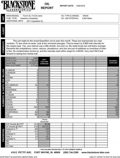

My latest report was good overall, but the iron and magnesium values have shot up considerably.
150,348 mi. 9/15/2019
191,689 mi. 8/2/2021

Looks like you had to add more makeup oil that last run too, did your driving habits change? More in town instead of highway?

This last oil change I did do more in-town than usual, but I've had an oil leak issue that I've been battling for awhile.
I emailed Blackstone and asked if I should be concerned about the change and the analyst said that my first sample was just really exceptional. She said the most recent sample is now within the average, so I shouldn't be concerned just yet.
