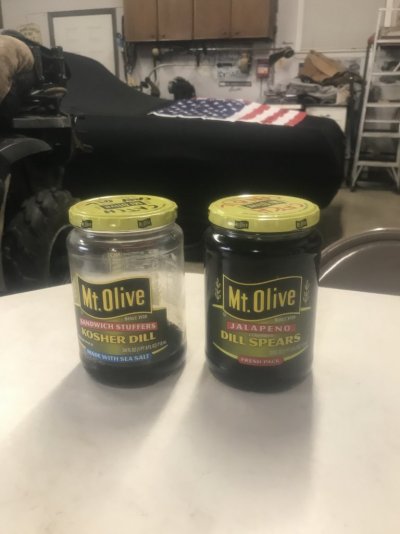

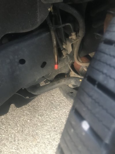

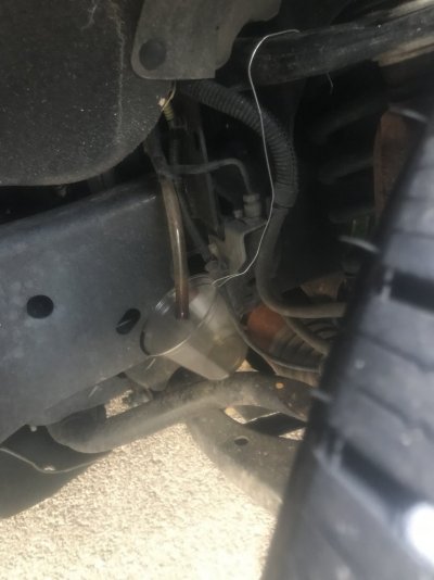

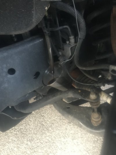

I just emptied my can a few minutes ago and this is my collective total of all that I’ve caught since installed at 8,000 miles and now 42,000 total equaling about 28 fl.oz. @ 34,000 miles. I cut the wheels to the left, hang a cup under the drain hose, pop the hood, and open the 1/4 turn valve on the bottom of the can mounted on the firewall. I shove a plastic plug in the hose end when finished and close the valve on the can and shut the hood….. very simple easy.BA35C905-C1AF-48EF-B0E2-6231365255B8.jpegAC26A81D-6715-4C28-B7DD-F431971624CA.jpeg66E2D26A-5F5C-4E53-A4AA-BC92A12589A0.jpeg45EB0496-A9F4-4F9B-AC7A-3EC495AC823D.jpeg

You do not want to dump the crap caught in an oil catch can back into the oil pan. That doesn’t make sense.
Yes even with no water in mine it still has strong gasoline dilution that would wipe your bearings if introduced back into the crankcase oil. As thin and strong smelling as it is I would guess it’s about 50/50 oil/gas.
