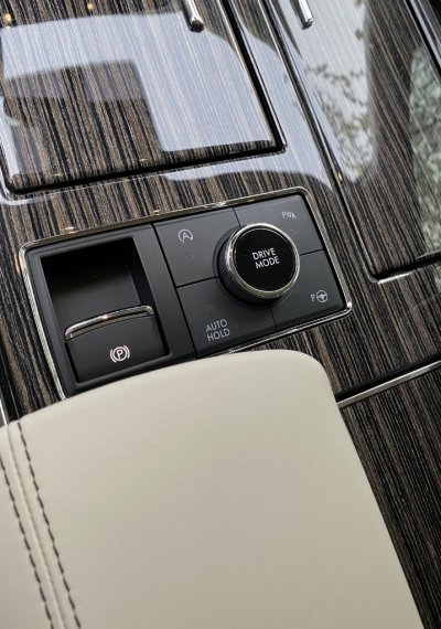

Navi doesn't get the buttons, but you get additional modes us Expy people don't have. Those additional modes give you the combos we can get by using the buttons. Page 217 of your manual.
Yeah that’s what I thought. I quoted the manual earlier in this thread so I was thrown off by the buttons comment,. Thanks26b6110303a7287d980d17608d8a54e0.jpg

Hmmm. I have HD/max trailering package on my Navi and there are no buttons that I’ve seen.
We don’t have a button to lock the diff, it will do it for you. At first I found that annoying, sorta like how we don’t have a button to enable tow/haul mode. I’ve learned that the vehicle knows what it wants for optimal driving performance a lot better than what I think it needs for optimal driving performance. That’s just been my experience. The e-locker is enabled in any of the 4x4 options except normal.

Does the Navigator have a dedicated 4 low button?
LokiWolf
Moderator
Apr 2, 2016
3,971
2,837
Richmond VA
It does not, but it has 4Low. It just has to be engaged by using the Steep Climb Mode.

i wanted the navi for those seats. best seat execution I've ever seen. one of the preschool moms has one and its sweet. but the lack of a true two speed tranny kills it for me
It does. Just has to be engaged via Steep Climb Mode. No button.
