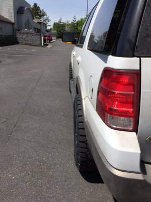

That looks sweet! Black and chrome is just enough to go with what the ex has. Very cool. I lean more towards black bc I absolutely hate how the OEM wheels look with pitting and brake dust, and they never feel clean to me even after spending 20-30 minutes per wheelHad Gear Alloy 713MB Double Pump on my white 2012 Ram. I'll be putting the same wheels on my black 2017 Limited soon.View attachment 24248
Man that thing looks mean! I'm surprised they don't stick out more being a +1 offset. Got any more pics?? I've got the wheel I want picked out, I just can't decide on the offset.
Here's more of a down the side shot. The protrusion isn't as far out as it appears from this angle. If you look straight down the side, the rear tires are right about even with the outside of the trim. +1 so, if you're going with a 12.5" tire, you can imagine a -12 offset sticking out about a half inch more, a -24" offset about an inch more, and a -44 close to 2 inches more.
Yeah that's not bad at all. I wouldn't run that wide of a tire either so it might be less than that. I wonder if anything has changed and if it would look different on my '15?
Either way the ones I was looking at comes in a 20x9 +18 or a 20x9 0. I've seen the 0 offset ones on a 2014 F150 and they stuck out a good bit that why I was surprised it didn't stick out that much on yours. A guy I work with just put some 20x10 -19 on his '15 F150 and they stick out a good bit, a little too much for my liking.
