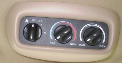

I just bought a new to me, lightly used one owner 2012 expedition limited with 26k miles. Very sweet rig. So I am not real familiar with expeditions. All the air controls seem to work great but when I went to turn on the heat for the second row it doesn’t blow out warm air. When I turn on the AC it cranks out loads of chilli air from the top second row vents. Am I doing something wrong with the controls? or is there some sort of heater blend motor that might be out? Any help would be great!

not sure on your rig, but I have a master control on my overhead, or remote control for the passengers sitting in back if on the latter, is the temp actually turned up?P3300076.JPG P3300077.JPG .

That’s what I was assuming as well. I read what other folks had to say and the majority of the people say that it is supposed to be like that from design, while the other folks were saying that they never noticed. So maybe the hvac system is designed to be operated in that manner. It leaves me scratching my head, but I jus wanted to get my question about it out there. Thanks

my 2003 doesnt do that. I can get heat or ac from either top or bottom depending on which vents I choose...Good to know that the newer ones work differently.
