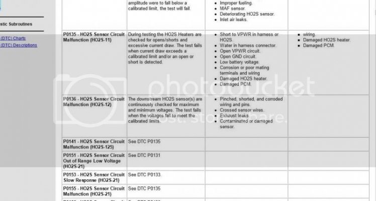

If you have to pass emissions test or vehicle inspection that would be different. But in either case I would not be in any hurry to do something and strangely enough cats are not listed as one of the possible sources in the ford shop manual. It just states the sensor itself is out of range.... This may mean its reading cleaner exhaust than possible!? Would sorta make sense with the list of possible causes. Just a guess?
