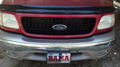

After trying several things to try and bring the grill color back, I gave up and painted it instead. I had originally wanted to take just the insert out, remove the ford emblem, and paint it that way, but it would have just been too time consuming. I ended up just leaving it on the truck, and used newspaper, and masking tape to cover everything REAL good to protect from over spray or drips. I used a good quality gloss black spray paint for plastic and went at it. Took more time to prep everything than it did to do the painting, but it sure turned out nice. Really makes the front end look nice again! Here are some before and after pics.

That looks great, man. I pulled my grill when I replaced the headlights last year and shot it separate from the truck. Not the most fun project (that is, the headlight changeover). I'd definitely recommend to anyone considering this to spend the time prepping the grill and then taping/masking things off and shooting on the truck like you did. And the advantage of using rattle can paint is the ease of touching it up down the road.

That's what Ford should have done to begin with.

Thats the exact same way I did the grille on mine truck. It was grey from years in the sun. My truck is black and it came out as dark and shiny as yours did, I think I would have matched the grille color to body color though.

That is how I did mine too when I put the Lightning headlights in. I went to a local autobody supplier and had them make a rattlecan of the factory color - I like the monochromatic look. I removed the Ford emblem and taped everything else off good and painted it on the vehicle.
