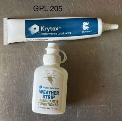

Hello,
Can you suggest which grease/lube you have used with good results. Considering that any sticky residue would be a magnet for dust and grime build up.
The grease mentioned in one of the TSBU as KRYTOX GPL-205 GPL205 is kind of expensive and hard to find.
Any alternatives that you - or anyone else may suggest for cleaning / lubing the rails for the panoramic roof to overcome the rattle. Although i only have the slightest of it in 2020 XLT, which becomes noticeable on uneven/bumpy surfaces.

Hello,
Thanks
TSB 21-2292 is the official procedure. It also lists the lubricants. The picture below shows what I purchased. I think the most important part is to lube the weatherstripping. I think most track breakages are due to the increased force required to open and close when the weatherstripping is sticking. 5BC370A6-5458-4B85-9472-DFDFF3A48C9C.jpeg

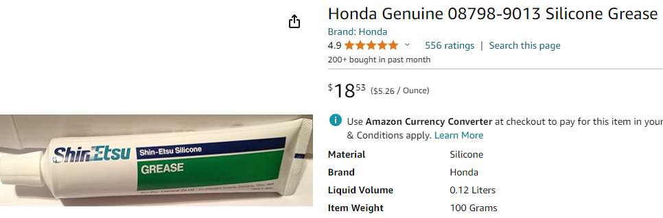

Use this stuff right here. Cheap on Amazon

Hello ,
So revisiting the topic after a while . After procrastinating for long I finally took on the task.
I did one pass with Krytox Products GPL-205 and Weather Conditioning Lube. Even though it is the recommended product as per the TSBU - the result were not long lasting and the chatter and rattle came back in 2-3 days, especially noticeable on uneven roads.
I re-did the whole procedure again, however this time I used an often recommended alternate product and the results have been good so far. Not sure whether it will stay like this after a full body wash, or does this process needs to be repeated every X no. of days/months. For now I am enjoying the rattle free silent drive and hoping it stays like that.
I tried this instead of Krytox. You can give it a shot and post results.
