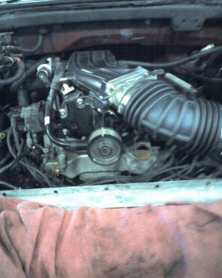

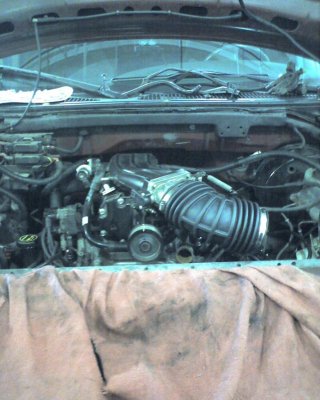

More pics for you guys.

kentv6...having added the lightning supercharger on my F150 and my wife's Expy, I HIGHLY recommend do the PCV delete and just adding breathers on the valve covers.
Reason: I bought 2 L&S oil separators (supposed to be the best out there) and oil got by them. Also ended up sucking oil from the driver's valve cover. Saw no difference between having PCV and no PCV.

On your lightning SC swaps, how many miles were on those engines? Just thinking your excessive blow by may have been from high mileage. My stock 5.4 had a consumption problem when I bought it with 137,000 miles on it, like a quart every 500 miles. I ran valvoline max life oil which is known for cleaning up stuck piston rings, and also ran a bottle of Zmax which also helps the same way, oil consumption is almost non existent now for the last 6,000 miles. BTW the first thing I did when I realized there was a consumption problem was install my PCV oil separator, I always run one in my vehicles. During the consumption problem I had to empty the separator every other day, now it's never got oil in it.

I have truck running on base tune and exhaust done no cats flow master exhaust. It sounds mean hope to have dyno soon I'am putting some miles on, breaking in engine. The trans. is the next weakest link.
