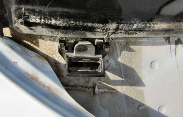

If it only happens when you encounter heavy rain look for signs of water under the hood, and inside behind the passenger side kick panel ( the security module and fuse box location...). Check the condition of the hood to firewall weather gasket. Are you the original owner ? How does the windshield seal look ? You may have problems at a few areas and the heavy rain just ties them all together for that symphony experience. You have a separate siren for your alarm? Usually it's just the vehicles horn that honks during alarm mode. An aftermarket security system could introduce a whole problem in itself.
This windshield support under the cowling is known to leak as well .... this is the area above the fusebox
I looked under the hood but couldn't find any wet connections. I didn't even think to look behind the RH Kick panel. I'll have to take a look at it tonight. I am not the original owner. I will have to take a look at the windshield seal also. As far as the separate siren, I thought it was Factory. It appears OEM anyway. I can take a picture under the hood when I get home. Also, this is a 2005 Eddie Bauer with remote start.

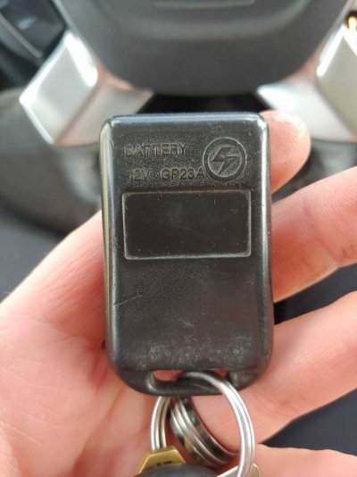

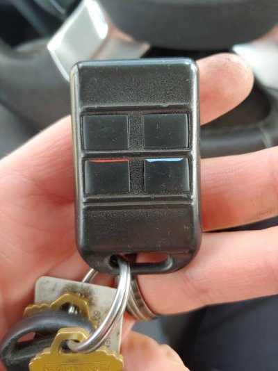

Is your remote start fob the OEM or an aftermarket? I am thinking maybe your alarm and start are aftermarket, and that may be part of the problem. The actual drivability issue you had with the rough running and CEL light, are consistent with plugs and or coils. the other stuff may just be bonus issues due to aftermarket system.
As far as I know, it is OEM. We've only owned this thing for about 1 1/2 years. I did plugs and coils about a year ago. FUN TIMES!
