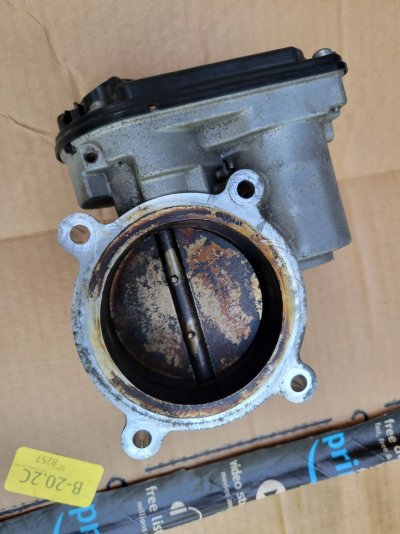

Got the new one in. Pretty easy job, you could definitely do this on the side of the road if you HAD to. 8mm deep socket/ratchet took care of the hose clamps and throttle body bolts.
The old one was pretty oily, more than I would’ve expected considering I have a catch can, but I guess I have no frame of reference for that thought.
Hope the problem is fixed.
Do you think cleaning would have helped? Doesn't seem to gunked up.

Hey Guys,
I figured I would add my experience in case it helped anyone. 2015 expedition with 147,000 miles. This happened to me 2 days after changing the transmission fluid, which might have been a trigger. Pulled out of the drive way, and wrench icon came on, and I lost all power to the vehicle. It was idling really rough, and I couldn't move the car at all. I tried to cut it off and back on about 5 or 6 times to see if it would reset. It didn't for me. Maybe it needs more time to reset. I hooked it to my truck and pulled it back into the driveway, and then came back later that afternoon to look at it. At this point, it did crank and I could drive it, but now the check engine light was on. The codes being thrown were P2111 and P2112. This forum and those codes led me to believe it was the throttle body. I was going to buy one, but local autoparts store out of stock, so I decided to just clean mine really good as I had some throttle body cleaner in the garage from a job years ago. I will add a picture below. I also came across a video on youtube that talked about how you need to recalibrate the throttle body after cleaning them or any work on the vehicle really, so I did that as well. I will link those videos as well below. I went for a test drive and all seems well at the moment, but really too early to tell. I will update if I experience the issue again.

Hey Guys,

Update: Just cleaning the throttle body didn't work. After I drove about 10 miles, the same issue happened again. Then on the way home, it happened again. I just purchased a new throttle body and installed it. I have now been about 50 miles with no issues. So it seems the throttle body was in fact bad.
