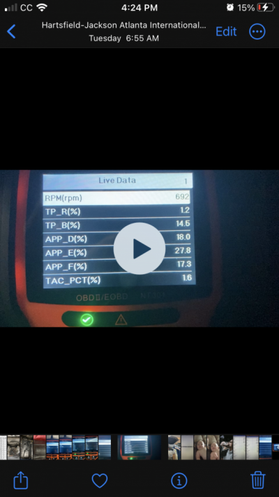

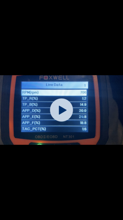

08TowPig
May 7, 2024
Atl Ga
These are before and after screenshots from replacing the accelerator pedal. I tried utilizing Forscan but it refused to connect. Any whos, the low power problem is fixed now. I have no real data to show what the problem was. Values D and E rose by 2% points. Apparently thats the difference. Hope this helps someone down the road. I intended to use the Forscan oscilloscope function to compare wave lengths but its a pretty useless program. Especially when it doesnt tell you “why” it wont connect.
