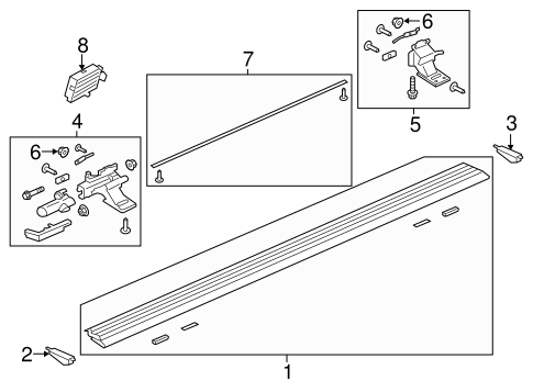

Here's a question. I know there are some folks on here with hidden search powers. Anyone know how to find the part with no part number here: https://www.tascaparts.com/v-2019-ford-expedition--platinum--3-5l-v6-gas/body--running-board
If you scroll all the way down to the power retractable running boards, you'll see part numbers 2 and 3, the front and rear caps. Anyone know how to find these? They have no part numbers and I just found a cracked rear one. I'm sure warranty won't cover it and there's no way you have to replace the hole damn step just for a cover. The fronts have part numbers but not the rears. Checked a few sites so far.

How can they Not be the same? The board is an extruded piece of aluminum, same dimensions from front to back. End Cap on Left front = right rear & Right front = left rear.
Not sure, a lot of things could be different, like the placement of screws, clips, etc. Even if they are the same, the least they could do is list the part numbers, or include that in the descriptions.
