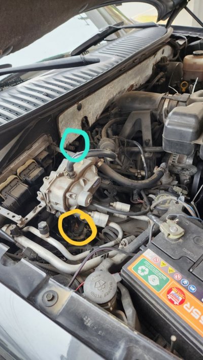

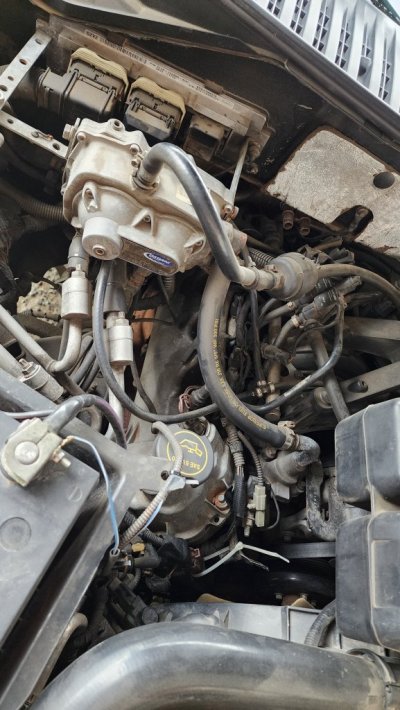

The setup. Injectors were bored through the manifold.

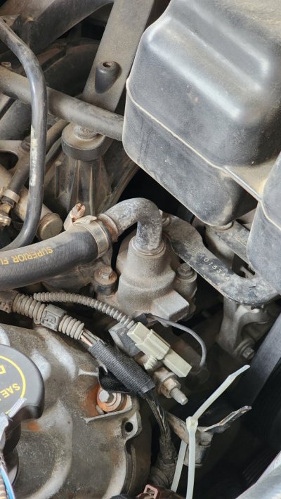

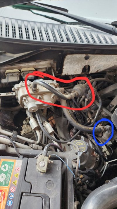

The thingamajig. Red goes to the injectors. Blue comes from the engine. What is that part and how can i remove the hose? Engine bay is so hot on that side, which is another reason i want to remove the lpg system.

When you discharge an aerosol can the can gets cold. When an lpg/propane regulator uses liquid fuel, the regulator will get cold as the liquid fuel flashes off to vapor.
Because of this there are usually coolant lines running to the regulator so it doesn't freeze.
Without seeing your setup, it's going to be a matter of-
Return coolant lines to stock configuration- (your Heater core has been disconnected entirely)
Return fuel lines to stock configuration-
Remove components that carry LPG-
Uninstall any tuning that was installed to facilitate LPG.
Uninstall any aftermarket wiring related to the regulator, tank, etc.
I know that's a little vague but it's difficult to go into more detail without seeing the complete installation.
