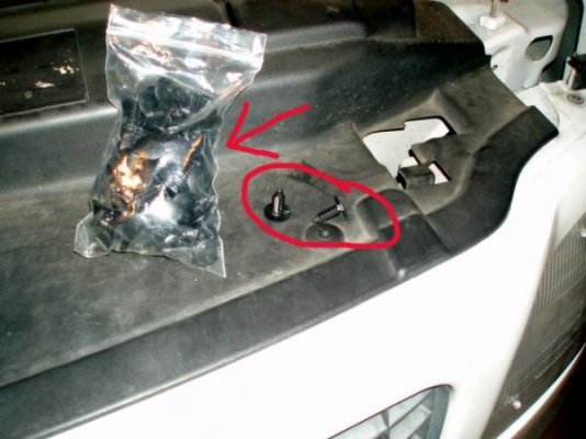

I mentioned supplies above. What I had bought some time last year was a bag of "Christmas Tree" Fasteners. Trust me when I say you will save a ton of time by cutting off the originals and inserting new ones. This bag of 100 cost $7.29 on Amazon (Search for GM, Ford & Chrysler 6.4mm Hole Retainer (Qty: 100) Gripper Box # 2000T).
Remove the cover that goes over the front of the radiator area. These Phillips fasteners sometimes will screw out, but sometimes have to be pried. If you pry them out, you most likely will damage them. I had a supply of replacements I salvaged from the junk yard, so it was no big deal to destroy them by prying. Not sure what the correct method is. I also see these for sale on Amazon as well.

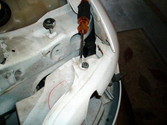

The next step is to remove the sheet metal screws along the top of the grille. There are also two more screws in each light bay.
Here is where you get to cut off the "Christmas Tree" fasteners holding the lower shroud (not sure what to call them) pieces to the grille. I used a sheet rock saw and slipped it in-between the shroud piece and the grille. These cut off fairly easy, but be careful not to over power it or you might do damage to yourself or the truck. There are four of these to cut on each side.

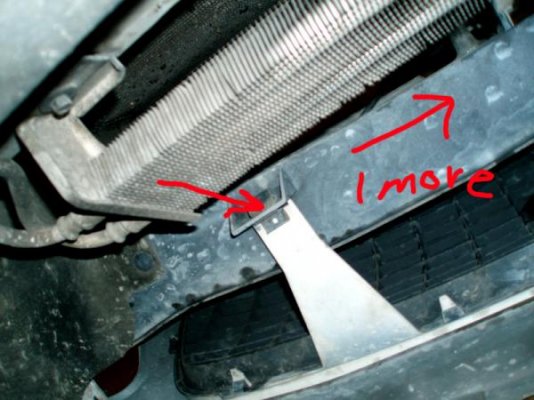

The next step is to get access to the quick release fasteners that support the lower grille. I had to pull off three fasteners toward the bumper to cause the lower shroud to drop. Be careful not to tear the shroud. These were moderately difficult to get un-done.
Once you have access to the underside, then press where indicated the support will pop right out. Two of these are on the underside. Make sure the grille does not fall out and hit you while under the car (standard block the wheels precaution applies here). Once these two are released, the grill should come right out.

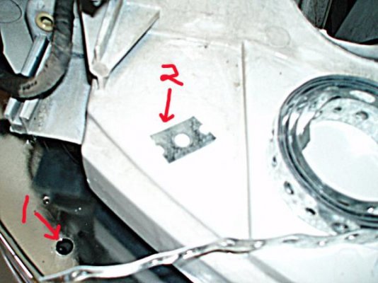

OK, there is always one snag. The replacement Grille had 3/8" holes, where the original grille had 3/16" holes. My solution was to use small strips of Galvanized Plumbers Tape to provide the backing for the fastener.
The above picture shows the plumbers tape holding the fastener in place. Worked really well.

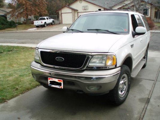

Once you have fitted the grille, reverse all the steps to fully install. Here is a picture of the finished assembly.
