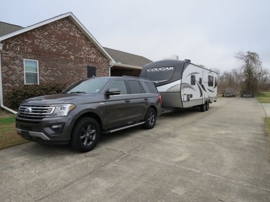

Our Cougar can gross out at 8800 lbs. Just wife and I so we load light and try to keep it under 8K pounds. Camper is heavy on the hitch and can get scary in high sidewinds. Payload is 1769 lbs and using a Equalizer WDH. Have 10 ply BFG KO2's and run them at 60 lbs when towing. I tow in the 60 to 62 mph range for better control over the rig. Any long trips I'll borrow son in laws F250 diesel!!
