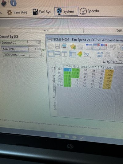

If your tuned for the 170 thermostat, your activation temperature for the fan is going to be different than whatever Ford tells them.
In my tuning, and I know a few other companies tunes as well, fans on a 170 thermostat setup are usually starting to come on around 185. Factory stock, the fans are commanded to low at 202.
Here’s some pics of the stock tables from an Expedition. Then pics show the differences in how a 170 thermostat tune is generally setup. If your tuner did it properly that is. This should help you and your shop.

Thanks this is good to know.
I do have the tune file from Adam with ZFG. I haven’t reinstalled it since early this spring when I had a torque converter replaced under an extended transmission replacement warranty. I talk with the shop Monday as it sounds like there are definitely issues with the system beyond the fans if the coolant temp is rising above the thermostat open point.
With the factory file it never got as hot as it did after I heard the pop and it would always stay cool in traffic, rarely going over 185 and quickly recover to between 165-170, so something has happened, will just have to continue to troubleshoot.
