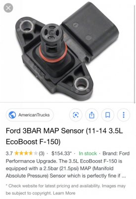

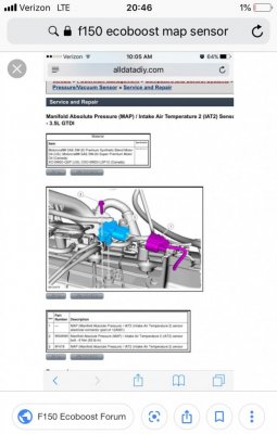

Ford went away from MAF and now has MAP. Manifold absolute pressure. Three of them on the ecoboost (IAT- Intake Air temperature, a MAP at the TB, and one above the manifold. Only the one on the manifold was ever dirty prior to my catch can. All three are always white now. Read up and get out from u set your rock, smart ass. Don’t say shit you can’t back up:flipthebird:

OK then, were are the MAP located and how are they getting fouled, with dirt and oil? How does a vehicle get out of factory specs and still run? There is a specific procedure for a re-learn. Its not a simple as disconnecting the battery. The shop I go to, claims you may trigger a CEL, when disconnecting the battery. The computer re-learning, the I/M are reset. I got the dreaded PO430, 1 day after disconnecting my battery.

It’s called blow by, direct result from the ****** direct injection engines. Thts why ppl get catch cans. This solved 100% of the issue for me. All 3 sensors look brand new now every oil change and the can catches a ton of gunk

About a year or so now. Put the catch can on passenger side as it’s the dirtiest. Cleaned all three MAP sensors and Thts it. I do my own full synthetic oil changes every 5000-7500 miles, check the can 2x between oil changes and check the sensors. The IAT Sensor on the intake tube and the TB sensor have never needed cleaning. The manifold sensor gets the dirtiest without a catch can
