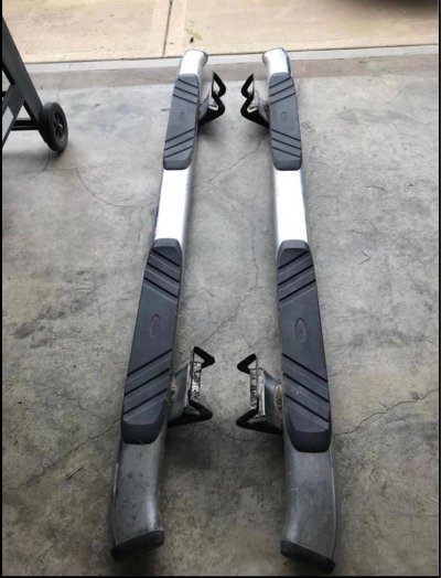

I have a 2007 Limited with the fixed running boards...and I recently purchased a set of 2010 F150 running boards (pictured)
from a local guy getting rid of his.
The distance between the mounts looks the same, the only modification I might have to make is taking an inch or two off each side since they’re slightly longer.
I’m going to try to mount them and see if it’ll all work.
